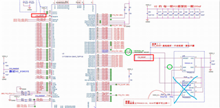

I would like to inquire about the usage of the MR pin on TPS3823. I have connected the MR pin to a GPIO on my MCU, and I am wondering if there is a required delay for the MR pin to trigger. After triggering the MR pin using the GPIO, I noticed that the GPIO may be pulled high immediately. Currently, the RESET function is not working properly. Are there any requirements for the usage of the MR pin to ensure proper operation of the RESET function?
Thank you.
  • I have attached my schematic diagram. The MCU used is CY7C6813A, which outputs a signal through a GPIO pin to the MR pin of TPS3823. Then, TPS3823 performs a RESET procedure on the CY7C68013A MCU. However, the entire RESET action is not functioning properly and often fails to RESET the MCU successfully. To resolve this issue, I need to add a small capacitor between the MR pin of TPS3823 and ground to enable the MCU to RESET properly.
    Please assist me in addressing any usage issues with this configuration. Thank you.

  • Hi Martin,
    Thank you for your question and your schematic. We are currently looking into your schematic and the issue at hand. In the meantime, can you please provide the signal that is being output to the MR pin of TPS3823 so that we may better assist you.
    Thank you,
    Joshua Austria
  • Hi, Joshua
    The signal is output from the MCU's GPIO to the MR pin of the TPS3823, and it is a 3.3V TTL signal. Typically, this signal remains in a high state, but when a reset is required, the MCU sets the signal to a low state, causing the MR pin of the TPS3823 to go low, triggering the MCU's reset pin and entering the reset state.
    During reset, the MCU's GPIO pin may be in a high state or a high impedance state, meaning that the MR pin of the TPS3823 may quickly return to a high state or a floating state.
    Currently, my solution is to add a capacitor to the MR pin, and I suspect that the use of the TPS3823_MR pin may require an active low state for a period of time to avoid abnormal output of the TPS3823's reset pin and prevent abnormal reset of the MCU.

  • Hi Martin,
    Thank you for your patience in these questions.TPS3823 requires a continuous low signal into the MR pin for TPS3823 to output a continuous reset signal to your MCU. In the absence of that signal, the MR pin will be left floating/high and TPS3823 will cease outputting the proper reset signal to your MCU as you noted. In order to ensure your MCU has ample time to conclude its reset procedure, the MR pin must be held low for that entire period of time. The capacitor that you added should add enough of a "delay" for the reset procedure on your MCU to conclude, as you have stated.
