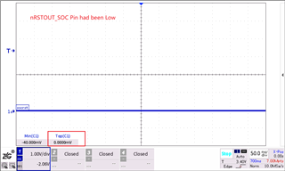

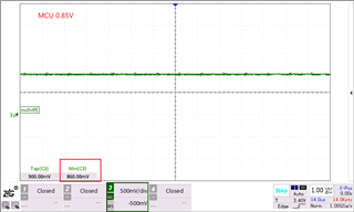

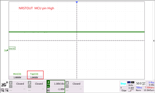

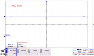

       I fail to only Reset SOC with using TPS65941212 + TPS65941111 to control TDA4vm voltage.
       I only set the  MISC_CTRL Register (Offset = 81h)  with the value "0x19" to Control for  nRSTOUT_SOC signal to  Low .
       Q1:  I check the  nRSTOUT_SOC signal have been Low,But my MCU didn't   normal running (like the MCU power has down) I don't have idea to solve this issue,Pls give me some addvise.Ths!
      As the follow picture is my MCU supply voltage & nRSTOUT_SOC signal pin..
      Q2:  I found my MCU didn't   normal running (like the MCU power has down) when I disable TPS65941111  -- BUCK1  voltage . This's the other question, Can you give some addvise to check?

  • Hello Qi,
    Setting nRSTOUT_SOC on the PMICs will not cause PMIC rails to turn off. It will only tell the SOC to reset.
    Disabling TPS65941111-BUCK1 will cause PMIC to interpret it as a fault on BUCK1. This will cause PMIC to enter MCU-Only mode and disable several rails.
    Please refer to the PDN-0B user guide for information on fault and interrupt handling. https://www.ti.com/lit/pdf/slvuc32

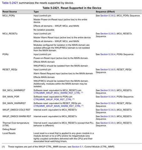

  • To reset only the TDA4VM's Main processing only, the warm reset RESET_REQz input pin can be asserted low or a SW equivalent bit can be set. Likewise, to reset the MCU & Main processing together, the warm reset MCU_RESETz input pin can be asserted low or SW equivalent bit can be set.  The "warm reset" term describes resets that occur without removing or cycling SoC's power.  A Power On Reset (PORz & MCU_PORz) occurs whenever a "cold reset" occurs which forces a power cycle sequence of the SoC.
    The TDA4VM reset control details are described in section 5.3 of the Technical Reference Manual (TRM) and summarized in Table 5-2421 (shown below). Please download the TRM from the TI's Customer Document Distribution System (CDDS) link given below.
