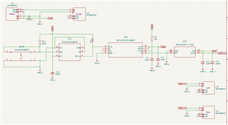

I have designed latched switch using TPS3422EGDRYR and SN74LVC1G74DQER. Schematics of this design is given as below. Input supply is 5 V. It works while in open load condition and show 5 V as output, but as soon as I connect main circuit with this board it drops the voltage. I noticed SN74LVC1G74DQER is getting hot.
Can someone please suggest what could be wrong? I went through the schematics but could not find any issue.
  • Hi Gaurang,
    Where is the load being applied too?
    Jesse
  • Hi Jesse, Load is connected with connector J70 and J73.

  • Hi Gaurang,
    The only concerning part of your schematic that I can see is the R70 is only 1kohm. I would typically recommend for the pull-up resistor of an open drain be at least 10kohm. Other than that the TPS3422 schematic looks fine. Since the load is interfaced through the BGA, I would recommend checking the current of PIN 5 of the SN74.
    Jesse

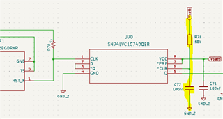

    With 800mA of unexpected current, I highly doubt that the SN74LVC1G74 is the primary issue. It is possible that it was damaged and has become a short -- is this happening in multiple boards?
    The 'LVC1G74 is a CMOS device, so the inputs must be fast transitioning -- the RC at the CLR\ input could result in damage to the device:
    This type of damage is fairly uncommon though, so if you are seeing this in multiple boards, it is probably coming from a different source.

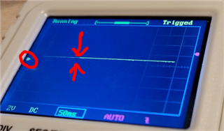

  • Hi Emrys,
    1. I have taken snapshot of input clock signal for 'LVC1G74 as you requested. Please take a look, it seems normal to me.
    Switch-Turn onSwitch - Turn off

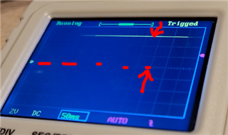

    2. To take the snap of signal on the output(Q) I removed U72 from PCB and probe oscilloscope on B2 pad of U72. I'm getting good signals
  • The time scale is absolutely huge -- these devices operate on the nanosecond scale. What I'm looking for is a discernible edge rate at the input that is faster than the requirement in the datasheet:
    From your video:

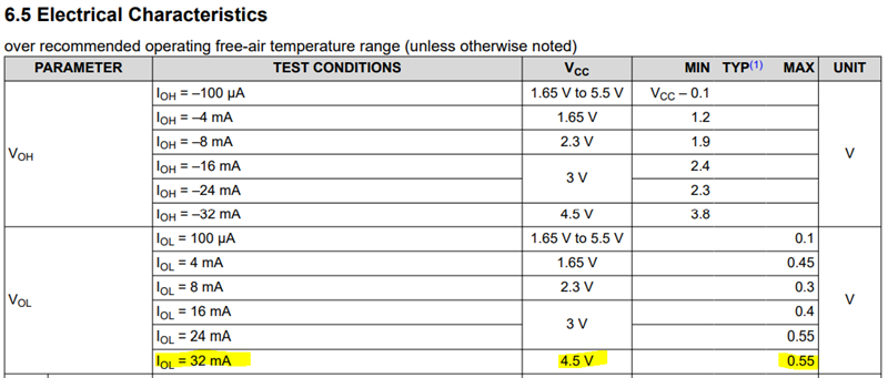

    I see that the output is offset by about 1V from the ground reference. This would indicate a large amount of current flowing into the output of the device when it is in the low state. From the datasheet:
    The worst-case V_OL is 0.55V with 32mA of current at 4.5V supply. This indicates a maximum resistance at the output of about 17 ohms.
    Typically the value is lower - closer to 10 ohms. Assuming you have a typical device, the output current is around 100 mA, which is in violation of the datasheet maximum output current.
    There is another possibility - if the output were damaged due to something like an ESD strike, the drive strength at the output could have been affected. I don't believe this is the case though considering the output signal is also clamping on the positive voltage side:
    It looks to me like something is trying to pull the output up beyond the operating voltage range of the device, and the output is clamping that voltage.
