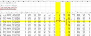

Hi Team,
The customer developing a mobile phone battery pack with BQ27Z561. They tested the performance of low-temperature boot (-15°C). It was found that the RSOC jumped from 33% to 0%. The figure below is the voltage waveform (5s/div) of Pack+/-.
The following is the gg file, several key configurations are as follows:
NT02_1000mA_20230328ú¿├╪├▄ú⌐.gg.csv
From the waveform, the time when the voltage is lower than 3300mV lasts for about 2s, which is less than Term V Hold Time=4s. Why does RSOC become 0? Should Term Voltage+Term Voltage Delta=3.5V be the threshold? Could you pls help?
HL
  • RSOC becomes zero because the gauge estimates that there is no capacity left at 15deg.C. It is not about Term V Hold Time or the Term Voltage Delta (which is not added to Terminate Voltage but controls how the gauge schedules simulations and calculates cell resistance close to end of discharge; There's another parameter, Delta Voltage in class State, which is added to Terminate Voltage for *simulations*, not to test actual measured cell voltage).
    Assuming that the ChemID has the correct temperature adjustment tables, the most likely reason for the sudden drop is how the gauge models self heating.
    The bq27z561 tries to estimate how much the cell heats up during a discharge. This will affect the estimated voltage during a discharge and, especially at cold temperatures, can unlock a lot of capacity as the voltage curve is typically flat. This is especially difficult for the gauge to model well, if Terminate Voltage is set so that it ends up in the flat area, which 3300mV likely is for -15deg.C and a typical load.
    The gauge learns how to estimate self hearting with state class parameters temp k and temp a. If these are learned at a different temperature (e.g. 25deg.C) then they may not be applicable to -15deg.C and lead to excessive heat loss with this extreme temperature difference in simulations, causing simulated voltage to drop significantly, more so than the actual cell voltage during a discharge.
    The best way to fix this is to run GPCRb (GAUGEPARCAL) with the battery in the final enclosure in a temperature chamber set to e.g. -15deg.C with the airflow blocked from the device. GPCRb then calculates temp k and a and it's possible to then restrict the gauge to use these values with temp k and a min/max in class IT Cfg.
    As a quick fix, increase the temp k value in the State class by a factor of 4 and set the temp k min/max parameters in the IT Cfg class to this value, +/- 10%. Note that temp k min is address 0x4622 and temp k max is at address 0x4620. Both are not visible in bqStudio. The actual value that you put in temp k in bqStudio is multiplied by 100. So if old Temp k is 0.88 [0.1C/256mW], then new Temp k = 3.52, Temp k min = 100 * 0.9 * 3.52 = 317 and Temp k max = 100 * 1.1 * 3.52 = 387.

  • Hi Dominik, I conducted a comparative test:
    1. Current project electricity meter model: bq27z561-R2, firmware number: 2_ 01;
    2. Model of electricity meter for comparative testing: bq27z561-R1, firmware number: 0_ 04,;
    3. The configuration parameters of the electricity meters tested by comparison are the same, and the same ChemID # 7153 is written. The tested data can be changed normally by FCC, RSOC does not jump, and can be discharged normally to the set cutoff voltage of 3.4V;
    4. So it seems that there is a problem with BQ27Z561-R2?
    Please confirm how we need to improve?
