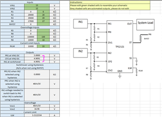

    The device will be evaluating PR1>CP2 to determine what input to designate as the output.
    Based on your schematic, at DC conditions the device will be attempting to determine PR1 (5V)>CP2 (4.9091V). These values are very close to each other and could result in a situation where the device switches back and forth between the two inputs.
    This bounce will not damage the device as this device has a break-before-make configuration which ensures the inputs are never both connected to the output. Additionally, this device has a thermal shutdown feature which will disable the device when it exceeds the TSD temperature.
    Other reasons the device could be disabled for a longer period of time could be a thermal shutdown trigger or overvoltage trigger, neither of which would harm the device. To avoid this issue, I would recommend the following schematic changes:

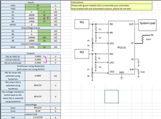

    • Altering your voltage divider on CP2 to add a larger differential between the PR1 comparison. For example, switching R513 to 45kohms would change the switchover voltage to 4.5V.
    • Adding a hysteresis resistor from ST to PR1
    This is how your schematic stands currently:
    This is what I propose:
    Do note this is not including hysteresis. Hysteresis in your schematic currently would do no good as the PR1 pin is connected directly to a 5V bias. To add hysteresis, you would need to add a R1 resistor as illustrated in the excel sheet.

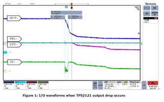

  • I have received additional information from the customer regarding the above, so please let me know your opinion.
    The customer measured the input and output waveforms of the TPS2121 when the output drops under the following conditions.
    ・ Added ST pin to the measurement point
    ・ Set the time axis to 1 ms/DIV
    The waveforms and their descriptions are summarized below.
    Could this waveform behavior be due to output switching bounce?
    Also, if you can think of any other suspicious factors, please let me know.
    ・The voltage drop of OUT for a long time (> 5 ms) occurs when the voltage levels of PR1 and CP2 overlap and OUT is switched. (see PR1, CP2, and ST in Figure 1)
    ・A bounce of approximately 200 μs occurs immediately after OUT switches from IN1 to IN2. (See ST in Fig. 1)
    ・In about 200 μs immediately after OUT switches from IN1 to IN2, the OUT voltage drops from about 13 V to about 8 V. This voltage is well below the IN2 voltage (approximately 12 V). (See OUT in Fig. 1)
    ・About 200 μs after OUT switches from IN1 to IN2, OUT switches from IN2 to IN1 again. (See ST in Fig. 1)
    ・Even after OUT is switched from IN2 to IN1 again, the voltage of OUT does not recover. continue to decline. (See OUT in Fig. 1)

    The switchover event is going to occur within 5us typical. To observe whether this voltage drop can be attributed to the constant switchovers, you would need to zoom in to ~10us/div.
    If you do not see a switchover every ~5us, Could you also share a plot of IN1 and IN2 for the time duration the previous waveform was captured.
    What I hope to conclude is whether the output is following either input, however I would expect to see a switchover between IN1 and IN2 powering the output every 5us resulting in a large output voltage drop.
    Elizabeth
