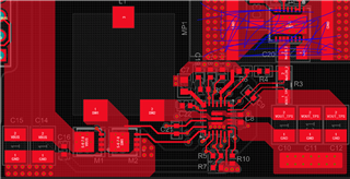

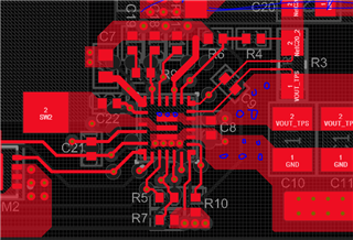

Good day.
For a project, I decided to use the TPS55288 as a variable DC voltage source. I have designed a working prototype board before but it had some flaws, which is why I want to check it first. I have included the schematic file. There is some additional circuitry, but I would like some feedback on the tps55288 part of the circuit. Some information that is not on the schematic:
Expected maximum output power: 40W
Maximum output current: 2A
Input voltage: 5 - 20V
Output voltage: 2 - 20V
Am I missing something important? I would like to optimize this design for a low-as-possible output ripple at maximum output power.
DC2DC.pdf
I will try to finish the PCB layout as well.

  • Hi CSC,
    Please see my comments below:
    1. For this application power range, we recommend TPS55289 which is four-MOSFET integrated and is easy for design and layout.
    2. For Layout:
    (1) Recommend to add more vias at Vout and GND copper plane.
    (2) Recommend to separate AGND and PGND plane at VCC cap. And connect all signal pins ground to AGND plane.
    Bryce
