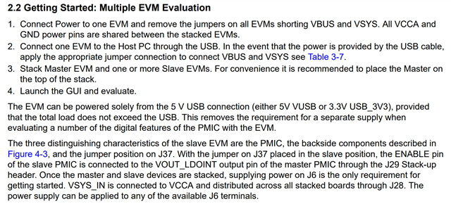

Hi TI expert,
I know that TPS65941111 is not meant to operate as a standalone device. Does that mean I would also need to purchase one TPS65941212 or TPS65941213? Would it be okay if I only use one TPS65941212 or one TPS65941213 without TPS65941111?
