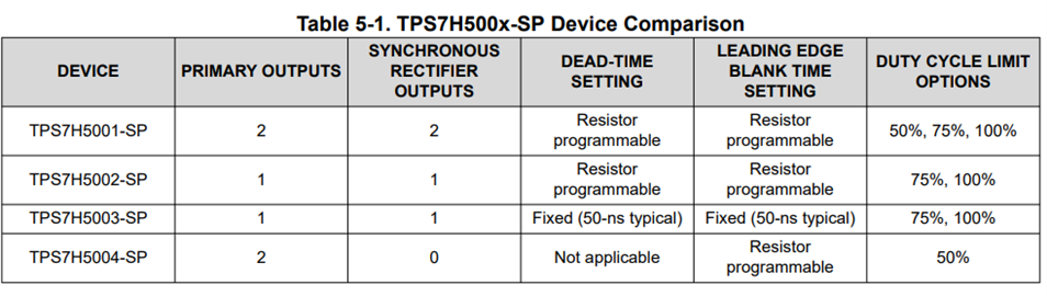

The TPS7H500X-SP family of controllers have both minimum and maximum duty cycle limits that have to be taken into account when using the controller
Maximum Duty Cycle
The maximum duty cycle is easier to take into account as there is an adjustable limit set by the DCL pin:
When designing for the maximum duty cycle there should be room between the operation duty cycle and the actual limit.
This is so the controller has room during transients and to grow due to losses in the converter
This number changes depending on many factors, but 10% for a 50% DCL limit, 20% for a 75% DCL limit, and 30% for a 100% DCL limit can be a good starting point.
The TPS7H500X-SP line of controllers can work with no minimum off-time when using the 100% DCL limit.
While this is fine for the controller, make sure any high side drivers you use in tandem with the controller can support the maximum duty cycle that you want.
The high side driver needs to charge the boot strap voltage it has in order to properly run the high side FET.
This can cause a minimum off-time based on the FET you pick.
