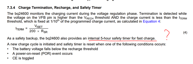

I am not so clearly understood on the meaning of 5h safety timer. There are no details described in the datasheet, can somebody help to give some explanation?

Hello Matt,
See attached thread about safety timer:
