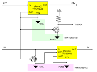

    Sorry for additional question about dVdT, would you please let me know three points below on above (TPS26601 ×2) condition?
    ・Is it okay to separate the RTN (PGND) pattern for the two TPS26601s?
    ・When VIN2 is already supply and VIN connect reverse input supply, is this also no problem?

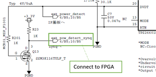

    ・Customer are considering a circuit that connects dTdV to FPGA in order to determine which TPS26601 is ON.
     Is the circuit below correct?
     Would you let me know if you have any other recommend idea?
    Satoshi
  • Hi Satoshi,
    1. Yes keeping RTN plane separate for two TPS26601 is fine.
    2.  Yes that should be fine.
    3. This looks fine. They can also use FLT pin for this purpose. Whenever FLT is low that means FET is off.
    Kunal Goel

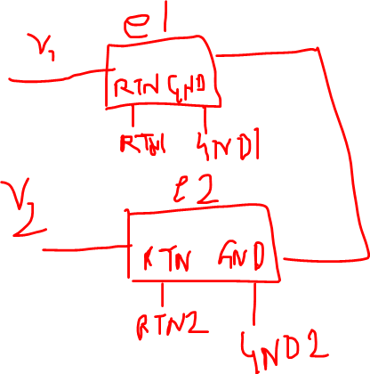

  • Sorry Satoshi I am getting confused.
    Are you saying this scenario?
    If you have some block diagram that will help.
    What is the concern? Some damage?
    Kunal Goel
  • Hi Kunal
    Sorry for less information,
    Block image is attached, please refer below;
    These are two supply rail and two TPS26601 line, separate RTN(PGND) pattern and common GND pattern.
    My concern point is damage of the FET on eFuse② side.
    When already 9V supplied and eFuse① line become reverse input connection, RTN pattern① will be negative (VGS = (dvdt-gnd)-(RTN-GND)) and no problem.
    I guess that RTN pattern② will be GND level, not be negative.
    In this case  I concern about FET swing negative, the VGS voltage may exceed the maximum rating.
    Would you let me confirm that above thinking correct or not.
    Satoshi
  • Hi Satoshi,

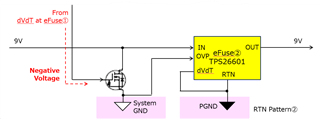

    You are right. Can we connect FET source to system GND and not to RTN plane?
    Kunal Goel
  • Hi Kunal
    Thank you for confirming,
    About FET source to system GND, I think that gate voltage will be negative and source voltage will be GND level on reverse input connection.
    What is the state of system GND?
    Also, is there any problem?
    Satoshi
  • Hi Satoshi,
    I got your point. You are talking about the case when eFuse 1 input goes negative. In that case eFuse 2 RTN will be connected internally to device GND pin(system gnd).
    So if we connect FET source to RTN2 or SYSTEM GND it will be same for the case when eFuse 1 is facing reverse polarity.
    So yes VGS will be negative.  But I dont think it will go beyond input voltage range. If we can choose FET of VGS rating near max reverse polarity it should be fine. FET can handle both positive and negative VGS.

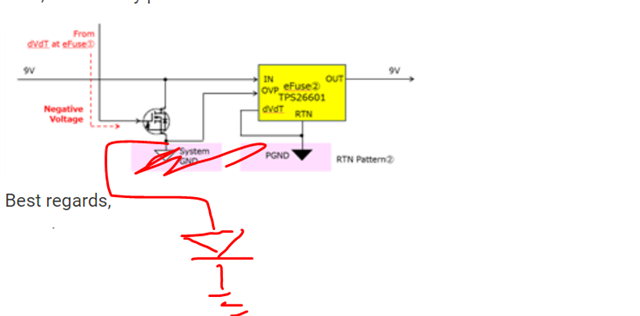

    Another way to block reverse VGS is to add a diode like this:

  • Hi Kunal
    Thank you for information, I understood.
    Another candidate for consideration has been added, which is a configuration that protects the System GND on the eFuse ① side as shown below.
    Is this enough to protected for reverse input connection?
    Would you let me know if you feel impossible, found the revised points, etc.
    Satoshi
  • Hi Satoshi,
    Looks fine to me.
