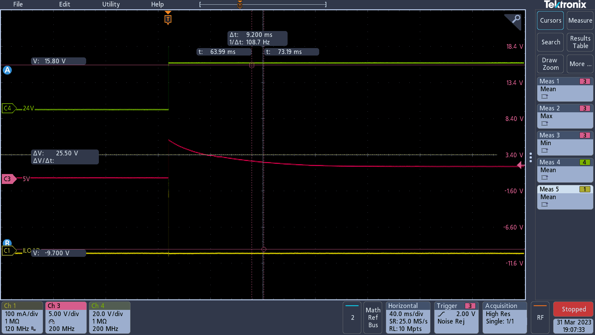

We are using LM5007 converter 24-5V step down application.
While we are testing LM5007 at -35degC at no load Vout (output voltage)  is dropped to 1.5V, if load is on then vout changed to 5V.
In datasheet maximum temperature of junction mentioned -40degC.
We need to know what will happen if  LM5007 power on at -40degC
    Do you have a waveform at a higher temperature to demonstrate the issue only occurs at ~-40deg? Additionally, can your provide the schematic for review?
    In future waveforms provided, please try to include SW measurement as well.

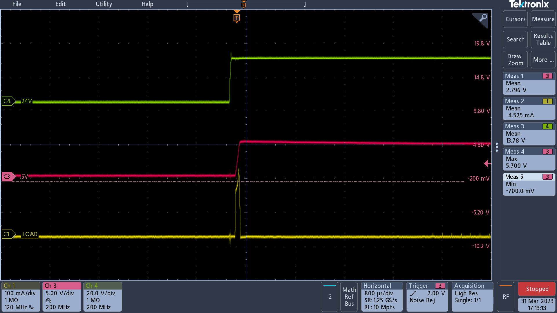

    We conducted no-load test at different temperatures -40,60degC.
    at 60 degC
    This device does require a minimum load current of ~1mA. This can be ensured by selection of the feedback resistor. VFB/RFBB > 1mA.
    Could you share the schematic so I can verify that it is OK?
    Once we confirm that the schematic is OK, I would like to see if you can verify the fix and also measure Pin2 and Pin1 when doing so.
    7.3.8 Minimum Load Current A minimum load current of 1 mA is required to maintain proper operation. If the load current falls below that level, the bootstrap capacitor may discharge during the long off-time, and the circuit will either shutdown or cycle on and off at a low frequency. If the load current is expected to drop below 1 mA in the application, choose the feedback resistors with sufficiently low value to provide the minimum required load current at nominal VOUT.
