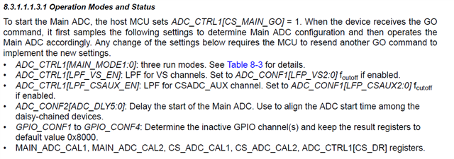

  • Hi Danielle,
    So you are able to read the correct values in CSAUX_HI/LO ok ?
    Could you try the below:
    1.Below are the full configuration steps, could you try doing the full set up before starting CS_MAIN_GO?
    2. Could you try higher VCS_RANGE( for example 70mV) to see if you can read anything off the 3 registers?
    3. Try doing a single conversion, then wait >13ms before reading the 3 registers
    thanks,
    Helen
