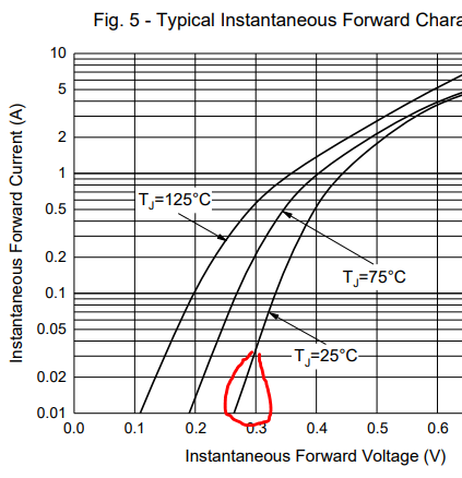

    2.7. VD is definefined as forward voltage drop of the flyback diode as its current approaches zero. Can you specify a diode forward current value at which VD is measured?

    Q2.7.  Please check your diode datasheet, and there should be a curve like this, and I marked the VD point:  use the voltage close to ~10mA point.
