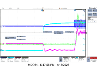

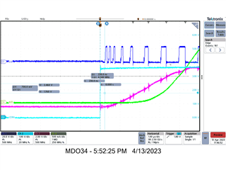

  • The initial soft-start for the converter can vary as a function of the capacitance used for COMP.
    In this example we have approximately 73us.
    Every subsequent UDIM high will have a much smaller delay because the COMP capacitor is charged and starts right up.  Delays are on the order of 230ns in this example circuit
    You can reduce the soft-start time by reducing COMP capacitance but there are limits there too.
    -Francis Houde
