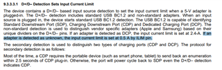

There are 3 questions about BQ25611D below.

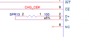

1. Is it DCP mode if the D+ and D- are shorted by 100ohm?

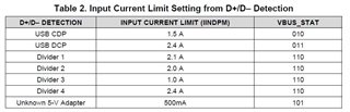

2. What does "adapter is detected as unknown" mean? Under what conditions will it be judged as unknown?
3. If an adapter is detected as unknown=> input current limit=500mA. Does it mean stop charging?
