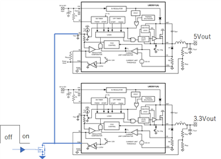

3.3V and 5V are generated with the attached circuit configuration.

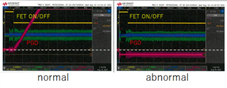

Even though 3.3V is being output, PGD on the 3.3V side does not become High-Z and has a negative voltage.
What causes PGD to be biased to a negative voltage?

Hi Sir,
Left picture and right picture is both output of 3.3V PGD pin?
Colin
Hi Sir,
I turned off this ticket temporarily. When you reply me, we can restart this conversation.
Hi Colin,
Yes, both pictures are 3.3V PGD.
PGD is a negative voltage on the abnormal side.
Hi Sir,
In abnormal picture, we can see that the PGD has been negative when FET on. I am afraid PGD is pulled to negative voltage by other circuit. Could you share the schematic to check further?

Hi Colin,
The PGD is only connected to SS and FET.
The PGD is negative voltage even if FET is removed.
No circuits are using negative voltages.
It looks like the PGD is driven to negative voltage inside the IC.

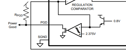

Hi Sir,
Actually the PGD pin is internally connected to the drain of an N-channel MOSFET switch. When there is no output. the PGD pin is pull down to GND.
Did you have a test about PGD is negative voltage that LM25011 working alone?

Is there any reason for the negative voltage to be output from the internal circuit of the IC?
Hi Sir,
Internal circuit of the IC can't output negative voltage and reference of IC is GND. I doubt whether GND of customer board is actual a 0V.

Hi Colin,
This is the waveform when using FET.
When the FET is ON, PGD is 0V, and when the FET is OFF, PGD becomes negative.
Normal and abnormal were confirmed by changing Ron with the same IC.

Hi Hirotsugu,
Please put a 10k resistor between SS pin and PGD pin.
Also I want to confirm that whether test point of V_PGD is PGND or AGNG, I would suggest test point is AGND.
Another thing I want to confirm is that when PGN is negative voltage, whether output of U41 is normal(5.5V).

Hi Colin,
Thanks for your immediate response.
I will try 10kΩ.
I would check the GND used for the test points.
U41 on the 5V side does not work when PGD is negative.
If I cut the connection with PGD, U41 works and outputs 5V.
