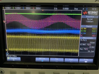

I use TPS552892 for VBAT input(9-16V) & output 12V application.
but in 15V input, the ripple almost 1V, then i found that my frequency setting is 2MHz, but in this case ,the SW is only 1MHz;
and when i change input to 7V, the SW is 2MHz, and ripple less than 100mV;
Could you please help explain this case?
thanks a lot!
Qin

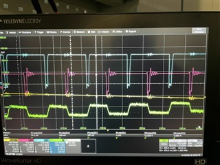

    3. Could you attach the waveforms of SW1, SW2, Vout, Vin, iL at 15Vin and 7Vin condition?
    >>15Vin \ no load as below:
    Yello--Vo(AC coupling)、Green -- iL、Purple -- SW1、Blue -- SW2
    >>7Vin / no load as below:
    Yello -- SW2、Green -- SW1、Purple -- iL、Blue -- Vo(DC coupling)

  • Hi Qin,
    Thanks for your detailed waveforms. I think this is because of the unsuitable loop compensation parameters which caused unstable loop.
    Please see my comments below and you can use the attached calculation tool to optimize the compensation by yourself too.
    1. Per current compensation parameters, the phase margin is negative. Recommend to change R406=15k, C212=4.7nF.
    2. Just curious, why do you prefer to use external 5V for VCC since EXTVCC is connected to GND?8585.TPS552892 Design Calculation V1.0.xlsx
