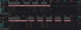

Our firmware drivers do not support smbus but we created our own implementation for the communication using the nrf_twim drivers.
  1.  We are following the Technical Reference Manual for BQ78350-R1A,
    if we follow the ManufacturerAccess() information we see that we should be reading 2 bytes for the size of the data. But when we are doing the same we only receive 1 byte for the size.
    For ManufacturerBlockAccess(), we receive 1 byte indicating the size (with the 2 bytes of the command included), the 2 bytes for the command and following the data bytes, this also does not match our reference manual. This is a capture from a logic analyzer.
  2. We are also having acknowledgement errors when sending / receiving, both on the address and the data.
    This does not always happen but we don't find the cause of the problem but this is causing problems in our current project.

  • Hello Jarni,
    1. Size is only 1 byte and not 2 bytes
    2. During normal operation some no acknowledges are expected. The host must retry after a few milliseconds in such cases

  • Sorry I should have provided more information,
    When we use the ManufacturerAccess() we see that the byte order is the same as for ManufacturerBlockAccess() as for ManufacturerAccess()
    And for size we only see 1 byte for ManufacturerAccess() just like ManufacturerBlockAccess()
  • The 1 bye size is part of the SMBus standard. The 2 byte size in the TRM refers to the actual data that is received.
    Check using bqStudio Advanced comm if the block data read contains the 2 byte size when using command 0x23. Since there are 2 separate paragraphs with the same description, it is likely that there is a mistake in one of them in the TRM

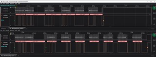

  • I think BQStudio only uses ManufacturerBlockAccess() and not ManufacturerAccess(),
    When I follow the TRM but for ManufacturingStatus 0x0057 instead of LifetimeDataBlock1
    a. Send LifetimeDataBlock1() command through the ManufacturerAccess(): SMBus Write Word of 0x0060 to command 0x00.
    b. SMBus Read Block of command 0x23: The first two bytes of the return block will be the data length and the next bytes will be the data of the command.
    The 2 byte size is not being sent.
    Also the write word function in BQStudio Advanced Comm SMB sends 0x0057 as 0x5700, do we need to do the same writing a word?
    When testing we see that both are working: 0x0057 and 0x5700
    0x0057
    0x5700
    This is a ManufacturerBlockRead() using BQStudio
  • Hello Jarni,
    Word writes require LSB to be sent first. So send 0x57 0x00 to write 0x0057.
    MSB first will not work. It is probably an unused command and was ignored by the gauge leading to a correct response.
