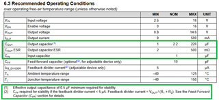

2.What should be the min effective capacitance at Input and output side of LDO?
Currently using single 10 uf at input and single 10uf  at Output side .Is this value acceptable ?
Can I use 100 nf at input and output side along with the above capacitor value ?

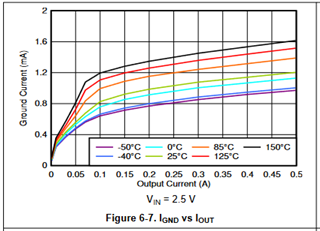

3. What will be Ground current (Ignd) for above operating conditions?

    The minimum effective capacitance on the output is 0.5 uF.  Your values of 10uF on the input and output is fine.  An input capacitor is not required for stability but it is considered good practice to include it.  You can add 100nF parallel capacitors to your 10uF capacitors provided that the impedance of the 10uF // 100nF capacitor does not droop below 2 m-ohms.
    The ground current will approximately be 1.2mA at room temperature, give or take based on your operating temperature.

  • How to understand this Dropout voltage 0.3 -0.75?
  • Hi Rackshith,
    The dropout voltage plot (Figures 6-11 and 6-12 in the datasheet) provide curves for -50C, -40C, 0C, 25C, 55C, 85C, 125C and 150C.  In my previous reply, I referred to "typical" as 25C.  At 125C the dropout will typically be approximately 390mV.
    The table snapshot you have provided gives the worst case conditions.  750 mV dropout requires that your load current is 500 mA, you are operating at maximum temperature (150C) and you have a large enough sample size to see an unusually large value of dropout due to tolerance.  Dropout increases with load current so at 300 mA you will not see 750mV as your dropout spec.  Figures 6-11 and 6-12 give a more common range of dropout voltages.  I hope this helps.

  • According to my understanding (Figure 6-6) Ignd  at 125 C is 1.4ma. Is this correct ?
    Will Ignd affected based on Vin ? Because my Vin is 10.380 V.
