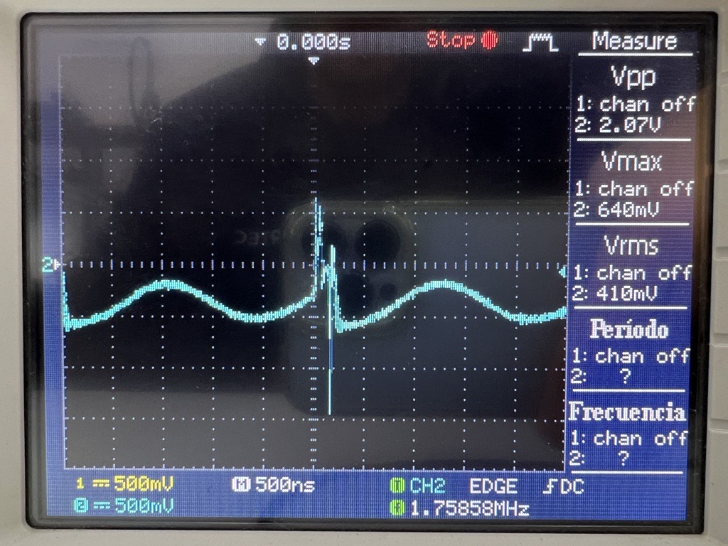

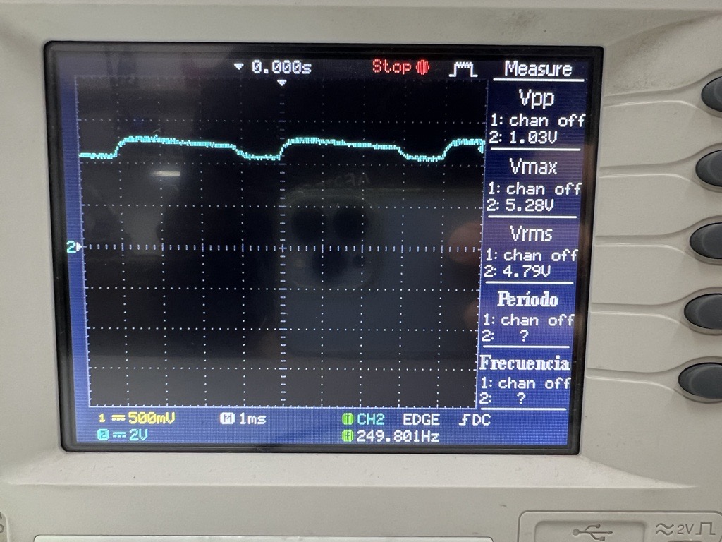

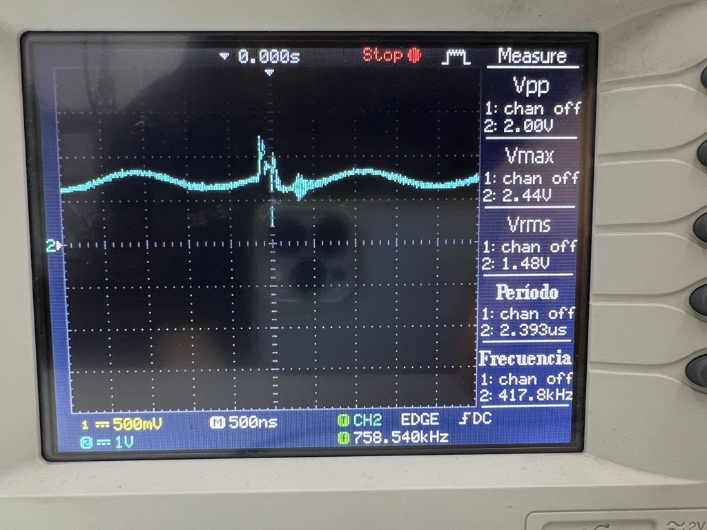

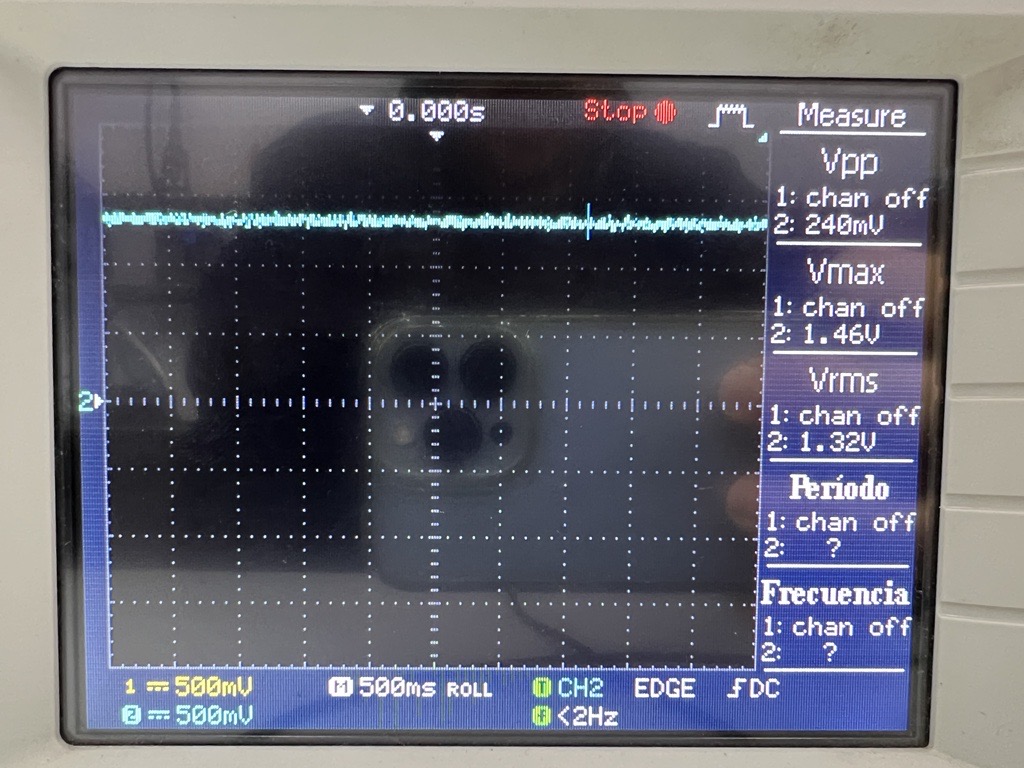

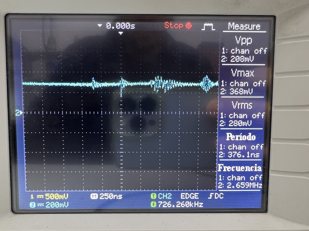

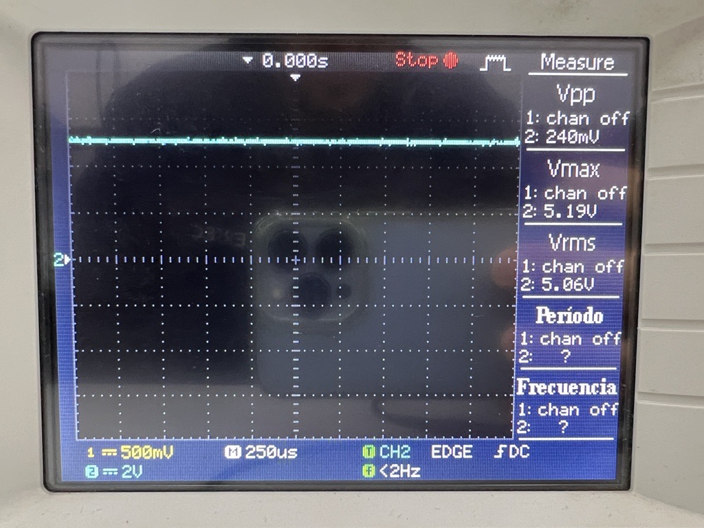

  • Hello, thank you so much for your answer! I attach the oscilloscope images:
    1) UVLO: (1.32V)
    EN: (5.06V)
    2) Vcc: (5.37V)
    3) SS: It looks like it is not ramping up correctly.
    4) COMP: (4.79V)
    5) HB: (1.48V)
    SW: (-400mV) It should be 12V, like Vout.
    HB - SW = 1.9V.
    Vcc = 5.37V.
    6) HO: HO is correctly connected to the gate of the high-side MOSFET
    7) LO: LO is correctly connected to the gate of the low-side MOSFET
  • Hello Pablo
    Something is totally wrong now. It might be caused by a wrong layout or  a wrong component population. And also there is a possibility the device is already damaged.
    • VCC should be around 7.4V
    • SS should ramp up.
    • HB should be at least the same as VIN voltage(even if the device is not working.
    • SW should be close to VOUT. Since the VOUT is ~ 0V. SW should be ~ 0V.
    Please check these items step by step.
    1. Review your schematic
    2. Review layout
    3. Double check the component values and directions
    4. Replace the IC
    5. Power on and check the VIN pin voltage
    Especially, please check if the HB diode is damaged.
    - EL

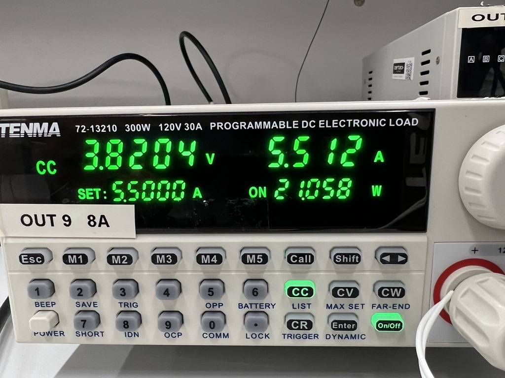

  • Hello! Everything is fine now, but I would like to ask a question, because the LM5116 is not working as expected.
    I am using a programmable electronic load to test the LM5116. I have designed the PCB for 120W (Pout), 12V (Vout) and 10A (Iout).
    When I increase the load from 0A to 5A, the LM5116 works perfectly. Vout is 12V and 60W with 5A.
    The problem occurs when I increase the load (e.g. 5.5A). The LM5116 does not work as planned and Vout drops to 3.8V. I have discard a temperature problem.
    I was checking the datasheet, but I can not solve the situation. Can you give me some idea of what is not working correctly?
    Thank you!
  • Hello Pablo
    If you are using the same component values as the WEBENCH recommendations, I guess  there is a noise injection to CS-CSG and the current limit is being triggered now. Please check if any improvement by reducing the current sense resistor value.

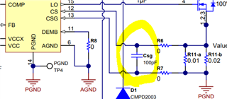

  • Hello Pablo
    Then, please double check the current limit of your power supply and check if any voltage drop at VIN when you increase the load.
    Also, please try to populate 100pF between CS-CSG close to the IC.
    -EL
  • Hello!
    There is no problem with the current limit of the power supply because it is 10A. Vin does not drop when I increase the load. I tried with the capacitor between CS-CSG, but Vout still drops when the load exceeds 5A (60W). I do not know why this happens, because everything is as webench says, and it works perfectly within 0.1A-5A. But it should work up to 10A.

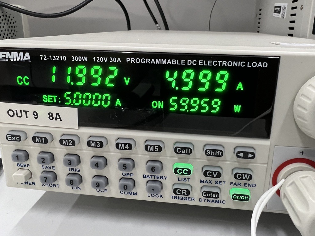

  • Hello Eric!

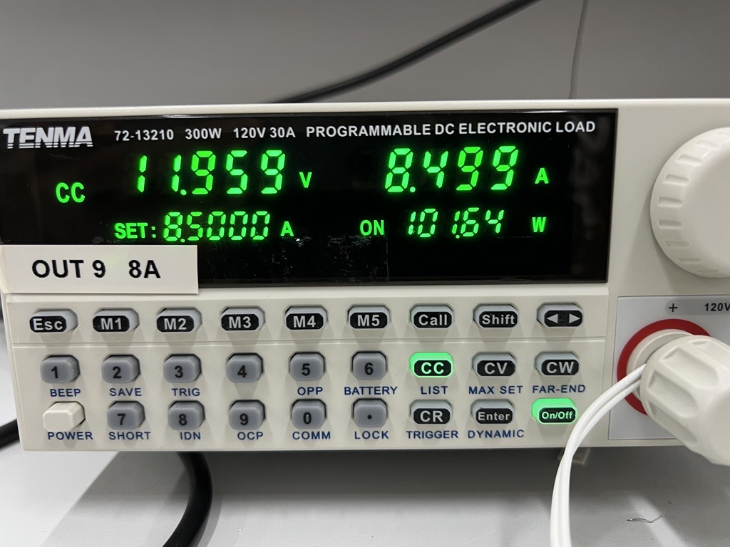

    I have been checking the layout, and everything seems to be fine. I have used a different power supply, another fan to cool the PCB, and I reach an output power of 100W, but with some problems that I would like to solve:
    - When I reach 100W (attached photo), the output voltage drops after 4-6 seconds (below 8V).
    - The maximum stable power is about 75W.
    - When the output voltage drops, I have to decrease the load a lot to make the system stable again. Maybe with 4-5A I can recover the 12V output.
    - The 100W are reached with an input voltage of 26-28V. When the voltage is lower (24V) or higher (30V), the maximum output power is lower. I designed the system to works within 20V and 60V, so it should not vary.
    Thank you!
  • Hello Pablo
    Since there is no circuit/component which has 4 -6 seconds time constant, I believe this issue is caused by temperature, if you have IR camera. please check the component temperature while increasing the load gradually. Especially, please check the temperature of IC, MOSFETs and sense resistor.
