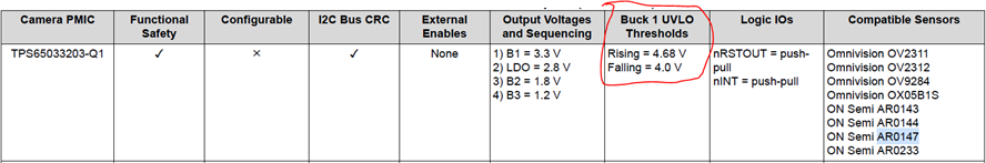

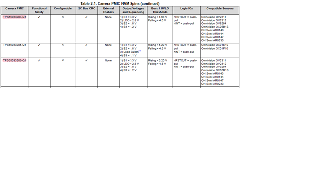

Hi
 TPS6503300D-Q1 can be used with On semi AR0147, whether it can also be used with On semi AR0148AT(AR0147+AP200) If possible, please provide a schematic...
Is TPS65033206-Q1 suitable for this? DC-IN: 5V DC out: 3.3V->2.8V->1.8V->1.2V (power sequence)
