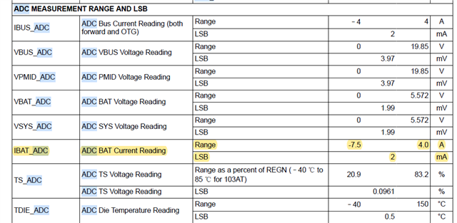

Hi Team,
I want to know the actual smallest OTG output current can detected via ADC, do we have actual test data on the EVM?
Thanks.
Anderson
Hi Team,
Thanks.
Anderson
Anderson,
The battery monitoring ADC of the device is offered as an extra feature in addition to the regular charger and is for reference only without specs. If the customer requires accurate ADC measurements a gauge device is recommended.
Ning.
