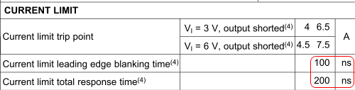

4.    On page 4 of slvs412d I read the following
What does “leading edge blanking time” and “total response time” refer to? Do they have any similarity to the concept of “rise time” in chip’s timing characteristics? From a macroscopic perspective, these 100ns and 200ns time are quite small, but since a 500MHz chip has clock cycle of only 2ns, and 100-200ns are dozens or hundreds of times larger than chip’s cycle time, would they have any negative impact on running of the chip?

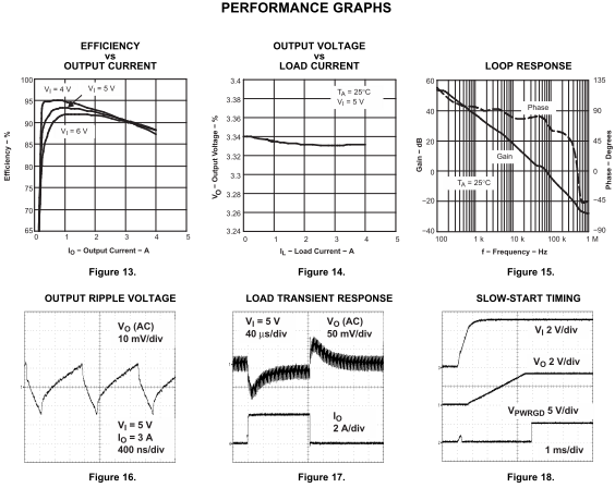

I also found “Performance Graphs” on page 11 of slvs412d and it seems to me that many of the questions above and find at least partial answers in the graphs. However, I lack the necessary knowledge to understand these graphs, particularly
1.Figure 15
2.Figure 16
3.Figure 17
4.Figure 18
Could anyone explain briefly the meaning of these four figures?
