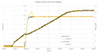

It seems there is an overshoot at power-up which energy is sufficient to destroy IC connected to the 3.3V rail.
The below scope captures, compare the power-up on the same unit using an LM2674M-3.3 not causing an overshoot (black) and one causing an overshoot.
Note:
- the secondary Y axis is the input voltage (12V limited to 200mA).
- the overshoot remains ~0.5V as limited by clamping diodes connected to an external 3.3V to protect IC.
Could you tell me what could be at the origin of such overshoot at power-up?
If after power-up, the 3.3V is shorted and then released there is no overshoot.
The inductor and the output capacitor values seem quite high compared to values from the datasheet. Could that be the cause of the overshoot at power-up?

    I want to say that you may be right in that the large inductance could be posing an issue. It seems like a lot of energy is being dumped out of the inductor after the soft start finishes. It is odd that the issue doesn't occur after a short circuit releases, as it is my understanding that coming of a short, the device has a similar startup sequence. To confirm, this failure is repeatable on the device? If so, it would be good to see some waveforms, with Vsw shown so we can better see the control behavior and if the low inductor current slew is posing an issue.

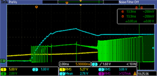

  • Thanks for your answer, I did not try with 100uH but with 330uH but did not notice any improvement regarding the overshoot (see below scope capture):
    CH1: input voltage, CH2: output voltage, CH4: switching node
    I have compared inductor and capacitor values returned by Webench to those currently used on our design and it seems the phase margin is probably too small on our design.  I am reluctant to use a smaller inductor and a smaller output capacitor as this product has been manufactured for year without problem and I only found one LM2674M-3.3 with an overshoot problem at power-up in a set of ~200.
  • Thanks, Gilles. Seems like you have a really slow moving vin. Sometimes that can pose issues and you might be bouncing in and out of boot uvlo (Vin very close to Vout). Have you tried startups with a faster slew? Also, can I assume this startup waveform was taken without load?
    If you have waveforms with a faster slew on Vin that would be good to see. Also, if you can provide a higher resolution image of this image, that will be beneficial.
    I cannot see what the Vin voltage is as the "zero-marker" is off the screen, but based on the mean statistic measurement annotated on the scope, it looks like it is around 5.2V. Please correct me if I am wrong.
