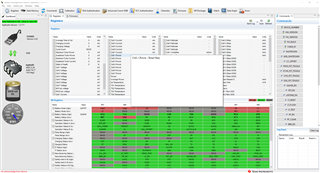

I recently received my custom made BQ40Z80 PCBs and I am not trying to communicate with them. I was able to communicate with one of the devices yesterday and change the Pin configurations and Cell configuration too. This morning, when I am trying to open the BQStudio app, but the device would not connect to the application.

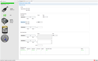

The application does autodetect the chip and opens the application, but the moment the application opens, the voltage is at 65534mV and current fluctuates between -8191, 0 and 8191. Any attempt to Refresh or scan gives me the error, "No acknowledge by device". I am using a 6S configuration and using the Test version of the BQStudio and the EV2400 which is present on my BQ40Z80EVM board. here is the image of the dashboard of BQStudio. I am shorting the Bat+ to Pack+ using a clip as opposed to the WAKE button on the EVM, and as soon as disconnect the clip, my board loses connection.
