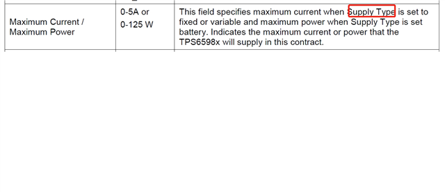

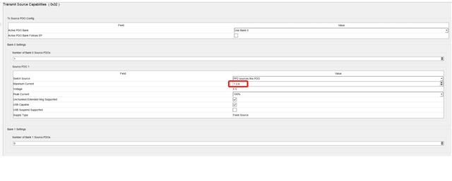

The customer has a question: TPS65987DDH, 5V output, hope to set the output current limit below 1.2A, when it is higher than 1.2A, it will be OC protection. But they adjusted the FW and set it at 1.2A, but it was invalid, and it was only protected when it was higher than 3A. Do I need to change other settings besides changing the current?
From the bottom, it should be the reason why "Supply Type" is selected as fixed, but there is no way to change it. If you want to set it as "Variable", where do you go to set it?
