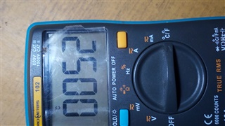

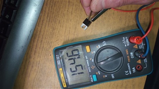

  • Hi Marshall,
    Thank you for looking into this.
    By fail do you mean the device destructively shuts down or the device goes into thermal shutdown (resolved with power cycle will long off time)?
    Chip fails - Vout = Vin. Between terminals 1 and 2 (LM2576) the resistance is 154 ohms. Attached is a photo of the destroyed chip.
    I designed the circuit according to the datasheet. Now my schematic looks like this:
    SCH_new.pdf
    The inductance of 150μH is indicated in the datasheet. I originally had 470 µH (0,6 A). Now I put 100 µH (1A). And in the Webench design, the inductance is 15 times greater (2.2 mH).
    So I bought such a board below where the inductance is 47 μH. It works normally and does not heat up at a current of 0.2 A to 1.5A.
    But I would like to ask why is my chip heating up? Now it has a temperature of 52-54°C.
    Please let me know if you need further information regarding our set-up.

  • Hello Jejomar,
    I have seen this board design before. It has came off ebay. The failure mode looks like EOS. I would confirm that they ordered from an authorized distributor. I am pretty confident they did not and the part being genuine may not be true.
