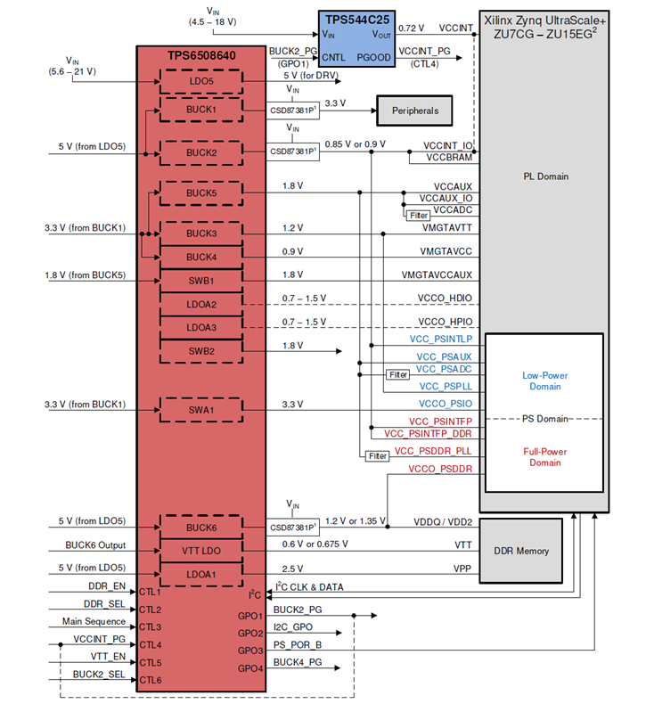

but how to define those VR groups? I could not find the corresponding registers, we plane to use  TPS6508640, and there is a example as follows.
ddr_en -> ctrl1
ddr_sel->ctrl2
Main_sequence -> ctrl3
VCCINT_PG ->ctrl4
VTT_EN->ctrl5
BUCK2_SEL ->ctrl6
but where are those controls from? can I use MIOs of ZU MPSOC to genertate these signal?

    For the TPS6508640, the CTLx settings are fixed in the 0x38 address. The registers in this address are set to work with the processor attachments in the picture you shared and we do not recommend changing them.
    For custom programs, I recommend using the TPS650861. This PMIC would allow the user to create custom CTLx sequences.
    The CTLx signals are usually handled by an external host or SoC before main power is available. The controlling device will need to be be able to pull CTLx pins above 1.2V to ensure active high enable.
    James
