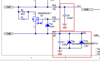

4.Do we need to add extra diodes on VC0 and VC1 to prevent negative voltage?

    4- The TIDA-010208 reference design uses a Zener and a Schottky diode in VC0. The Zener protects the pin from high voltages that could exceed abs max. The Schottky diode protects the pin from too low of voltages. Notice how we also reference the VC1 and VC0 filter caps to GND. This is to ensure BAT- does not go below VSS.
