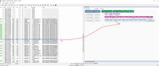

    I was able to load your configuration onto a USB-C-PD-CHG-EVM and the configuration itself is fine and device behaves normally as it should. I was also able to capture I2C transactions between TPS25750 and BQ25792 and they are the correct transactions to slave address 0x6b to configure for a 3S battery, please see my capture.
    It seems maybe your I2C decoder is chunking data or shifting. Try and deleting data before I2C communication to BQ device and see if that correct I2C decoding.
    I was also able to capture PD logs and the device is sinking the requested PDO correctly as it should, please see log:
    I was only using a 5V, 3A source to test with.
    The device also operates normally as it should since the BQ device will goes through a test sequence to see if a battery is attached before it will enable the converter. Therefore, if you have battery connected then connect Type-C cable the device will operate as it should since the BQ device sees a battery connected and the TPS25750 will send the I2C commands to configure for charging. Whenever you disconnect the battery and reconnect it, the BQ device would have disabled the converter and will only be re-enabled until we send another charge configuration I2C transaction which will not be triggered since the TPS25750 has no way of handling this battery condition. Therefore, the only way you will get this to work is if you have a connect condition on the PD to send the I2C events to BQ device.
    The BQ device may issue an interupt whenever battery is connected, however PD will not be able to handle this interupt. You would need an MCU to handle this interupt, then use I2C read and write through PD to configure BQ device for this condition.
