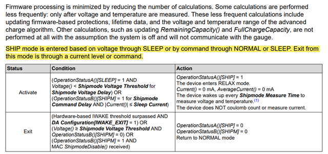

Will grounding the ENAB pin prevent the device from entering shutdown mode normally? The customer reported that the power consumption in shutdown mode is 12uA is observed via a multimeter . We checked the conditions to enter shutdown mode, but everything look good. Could you pls help?
