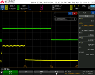

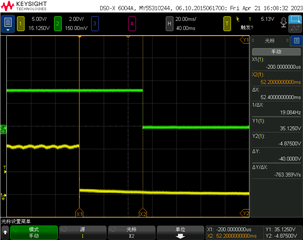

         The customer has set the registers as we discussed before. They found that the DDSG followed the DSG.But when RSN and RSP find the short, the DSG was pulled up first, and after t 30-50ms , DDSG followed the DSG. Time of following is quite long the the short protection. I remembered that the DDSG would follow DSG within 1us. Is there other registers need to set?
    The DDSG is green and the DSG is yellow.

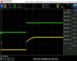

      But when the power up the BQ76952, the DDSG follow the DSG within serval seconds.

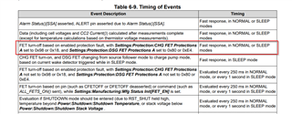

  • Hello NAN,
    Do they have the CHG FET Protections A and DSG FET Protections A registers set to the below description? The device will take up to 250 ms if they do not do this.
