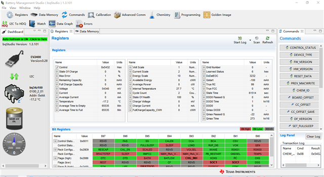

We have a new question about BQ34z100. Recently the customer use BQ34z100 to test battery. But as shown in the figure, at -20℃, the capacity of the power-up initialization of the fuel gauge is 0 for both FCC and RCC. And if they raise the temperature above -10℃,they will get a normal data. Have we ever had a similar situation? Or do you have any advice? What designs or operations do we need to focus on or check?

    Cell attach must be done at room temperature. The gauge will only set parameters after it initializes. At such a low temperature, the initialization routine may return error.

    So do yo mean that the system can't initialize in -25℃?As you say, gauge will only set parameters after it initializes, but in customer application, they have to initialize at -25℃? Do you have any advice how to solve this problem? Or after a single initialization at room temperature, can  the system no longer be initialized, and can be operated directly at -25°C?
  • Does the initialization need to be repeated every time when the reboot occurs?
  • Hello Hale,
    The bq34z100 is normally used on pack side where it is always powered, so initialization is entered only once.
    Another point to note - At -25C the FCC will actually be lower and some batteries have barely enough power. Did you run the GPCRB optimization for low temperature after doing GPCCHEM?
