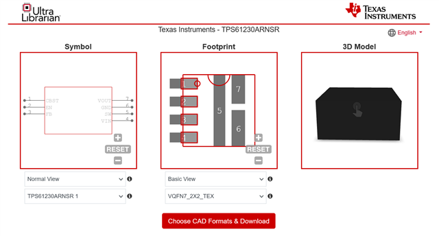

There is a link under the Download column, labelled "View Options"  https://vendor.ultralibrarian.com/TI/embedded/?gpn=TPS61230A&package=RNS&pin=7&sid=lit344e7360344e7360344e736062da538c125f046&c=1
Following this link takes you to a page where you can download a footprint library (Ultra Librarian for TI). The footprints provided are wrong when compared to the data sheet. The pads are incorrectly numbered.

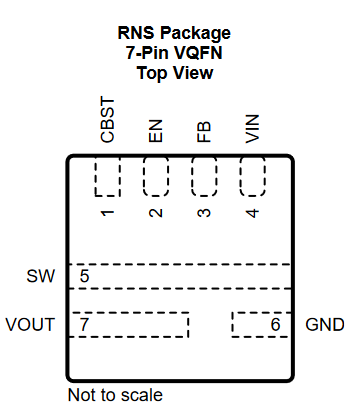

Screenshot #1 below shows the footprint with pin 1 in the top left corner, whilst the datasheet indicates that pin 1 should have been in the bottom left (see Screenshot #2 below).
Screenshot #1 showing Incorrectly numbered pads in the footprint
Screenshot #2 showing the datasheet's pinouts.

    In screenshot #2 it is top view, but in screenshot #1 it should be bottom view. So it should be ok, I think.

  • Sorry Nathan, but that is not the case.
    The footprint library has the pads on the top layer. Also note that pad 7 in screenshot #1 is smaller than pad 6, but pad 7 is larger than pad 6 in screenshot #2.

    P.S. the footprint for this part on SNAP EDA appears to follow screenshot #2, which reinforces by belief that the Ultra Librarian footprint is incorrect.
