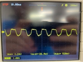

I see an 800mV on the output rather than the 25V and I am not sure why. The VCC pin reads 7V and the EN pin reads 13V. One thing I found strange was that the UVLO pin was reading below 1.23V when 24V was connected to the input, but when I raised the input voltage enough to bring the UVLO pin above 1.23V, I still didn't see any change on the output, so I don't think this is the root cause. Below is what I see on the HO pin, which I thought was strange:

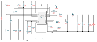

There aren't any major differences between the passives that I chose and the passives in the WEBENCH design. The biggest thing that I could think of is that C21 from the eval board (used to control hiccup timing) is not in the WEBENCH design at all.

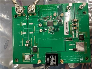

Here is a picture of my board:
Here is the WEBENCH circuit:

  • I put the original high side FET back and now this is what I see on the HO pin. It just stays at 1V after it ramps up initially.
    I don't see anything voltage across the current sense resistor.

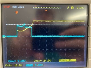

  • I don't see any voltage across the current sense resistor. This is what I see on startup:
    Blue is voltage across CS resistor and purple is Vin.
    I got my I1peak to be 1.82A and my I2peak to be 3.48A from equation 15 in the data sheet from section 8.2.2.3 Inductor Selection.

  • Here are some pictures of some of those signals at startup. The blue is the specified signal and the yellow is Vin.
    EN:
    UVLO: Hard to get start up picture because of smaller time scale needed.
    HO:
    LO:
    SW1:
    SW2:
    It looks like LO tries to start switching but then stops immediately. The UVLO pin looks like it is operating in a fault condition, but I'm not sure what it would be other than over current. Is it possible I need a different current sense resistor value?
    Soldering looks good. I tried reflowing everything just in case, but didn't see any changes.
