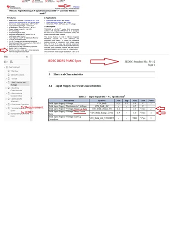

Hi, My Friend:
When studying JEDEC DDR5 PIMIC spec, I found Bulk Input (VIN-BULK, 5V) of DDR5 UDIMM/SODIM is restricted  as below:
1) BULK Input Ramp UP = 0.1 ~ 3.0 V/mS
2) BULK Input Ramp Down = 0.5 ~ 1.0 V/mS
I also surveyed the datasheet of TI TPS53353, which was designed in Intel Raptor Lake-S Platform (RPV). My questions are:
1) Dose the soft-start mechanism of TPS53353 achieve "5VOUT Ramp UP = 0.1 ~ 3.0 V/mS?"
2) Is there any property of TPS53353 to achieve  "5VOUT Ramp Down = 0.5 ~ 1.0 V/mS?" Which page of TPS53353 datasheet shows it?
I emphasize that TPS53353 is designed in Mother Board and to offer 5V to Bulk-VIN of UDIMM or SO-DIMM.
Many Thanks!
Sen

  • Hey Sen,
    I understand. The startup phase should allow the part to reach JEDEC spec, assuming the correct soft start time is used. For example, 0.7ms soft start time at a vout of 5V would be 7.14V/ms ramp up. 2.8ms soft start would be a ramp of 1.78V/ms.
    Ramp down can be seen in Figure 6-15. Looks like it meets the spec as well. This will depend on the load, which is why it is not characterized.
    Caleb
