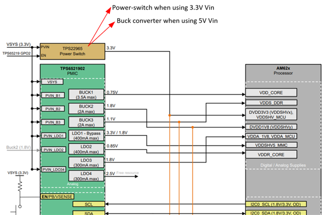

  • Hi Tim,
    Any of the TPS65219 variants can be supplied by 3.3V or 5V (as long as the PMIC outputs are configured for <3.3V). This means TPS6521902 can be used for 5V Vin, LPDDR4, CORE=0.75V or 3.3V Vin, LPDDR4, CORE=0.75V. For the 5V Vin, the external power-switch is replaced with a Buck as shown in the capture below.
    I also wanted to include the link to the TPS6521902 TRM which shows the default register settings: TPS6521902 Technical Reference Manual. Feel free to let us know if you have any questions. Robert Finger can help to identify the external supervisor based on your application requirements.
