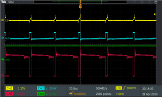

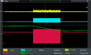

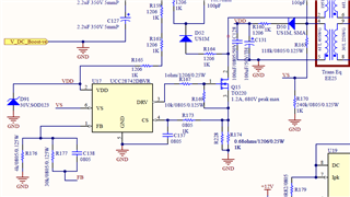

Hello Sir/Madam,
I have designed 25W,18V flyback converter using UCC28742. We are facing issue during startup. IC is turning off after around 900ms.
Below are the attached waveform of CS, VDD, AUX(VS gain is 10/57) and VDS.
I believe all the protection are within the limit.
Could you please help us in rectifying the issue. I have already referred the troubleshoot document (https://www.ti.com/lit/an/sluaac5/sluaac5.pdf?ts=1681906025110&ref_url=https%253A%252F%252Fwww.ti.com%252Fproduct%252FUCC28742)
Rlc=4.7k, Ccs=1nF.
Please let me know if there is any further data is needed.
