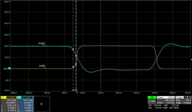

    Below is the Waveform of High Side MOS VDS and Low Side MOS VDS.
    Vin : 20V, Vout : 5V, 3A.
    Does there have the risk of shoot-thru?
  • Hi Alan,
    Can you probe the DR1H, DR1L and SW1 waveform as below, so that we can see what is the real dead time now, we can’t see it from the below picture. Please (1) use BW=500MHz voltage probe; (2) turn off the scope channel BW limit; (3) change the SW1 voltage scale to 0.5V/div.
    Also, it’s better to probe Vin voltage, add 20V offset at the channel and see if Vin decreased during the dead zone and if there is shoot through happened.
     I will also look into the layout if there is any risk.
    Bryce

  • Hi Alan,
    Thanks for waveforms.
    I still see the Voffset at each channel, is it the scope mistake?
    From the waveforms, as you can see, there is a delay between DR1H falling and SW falling due to toff time>ton time of MOSFET. And after the internal driver dead time, DR1L rises. I think there exists risks when SW is falling to zero(high side not totally turns off but low side turns on), and in some cases, the dead time becomes smaller which could cause the shot-through time gets larger and finally FET damaged.
    From the waveform below, you can see there is two negative dips of SW waveform(red), that is the dead time and it can make the shot-through not happen.
    Bryce

  • Hi Bryce,
    If we want to solve this issue, Could we change the high-side mosfet with a shorter Td(off) ?
  • Hi Alan,
    I think it's better to choose MOSFET (both high side and low side) with lower Qg with smaller tr and tf spec(tr and tf should be more symmetrical).
    Bryce
