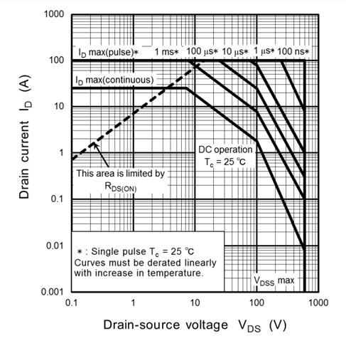

    Second thing is that I feel during this period it affects the Safe operating area of the device. This could probably be the reason for blowing of FETs at startup
    Can you try to check at other lower loads than 1KW and see if there is any difference? Also if possible try using a higher current rated FET temporarily to see if this is what is causing the failure.
