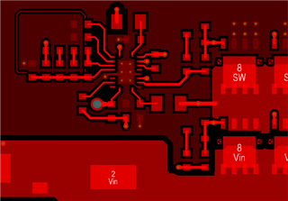

The layout closely follows the TI recommended layout in section 11.2 of the part datasheet.

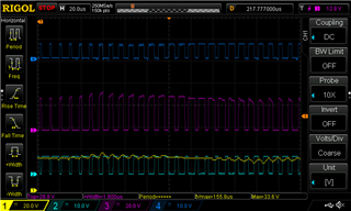

When I start to bring up the supply, with no load attached, the supply audibly "sings" and the input supply overcurrents and sags the input voltage. Connecting a scope to the switch node shows that the low side FET appears to be turning on with the high side FET on. Waveform and Webench design attached.
Magenta is switch node, Blue is output voltage (target is 12.5V), yellow is input voltage (initially 30V at 3A)

    It looks like both of your FETs are turning OFF, and SW node is ringing around VOUT.
    This is normal for diode emulation.
    You can check if the FETs are both on (cross-conduction) by checking HO and LO.
    Are you starting up into full load or no load? Does this happen at no-load?

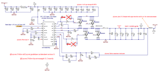

    My schematic is attached, I will download and fill out the Excel sheet and post when finished, I had not previously used that tool, I was using the webench design I attached.

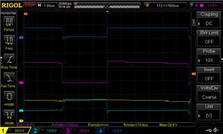

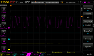

  • I probed the HO and LO drives, attached are the waveforms, the magenta is still the switch waveform, however with the probes attached it appears to look more like it should, the current load on the bench supply is still high for no-load but is not tripping,we did increase the current limit to 5A on the bench supply.
    They are in order, the dark blue is HO relative to the switch node, light blue is LO relative to gnd. The yellow is the input voltage.
    The supply still makes audible noise. We discovered that by changing the leads from the bench supply to minimize resistance and inductance we could change the magnitude and frequency of the audible tone. also by including and removing the input filter.
    close up shots of the HO, SW, and LO show there is dead time. I am going to use the Excel sheet you linked in the first post to review the compensation network and then tomorrow plan to remove two of the four FET's.  The resistors were confirmed to be zero ohm. The HO and LO traces from the FETs to the IC appear reasonably short and fat.
    other than the loud audible sound it appears closer to what I would expect, the bench supply says 0.4A @ approx 30V or 12W with no load. We have not tried to let it run for more than a few seconds at a time, just enough to capture the waveforms and attempt to look at thermals.
  • Going back and reviewing the Webench design attached to my first post, M2 specified is a BSC240N12NS3 G, which is obsolete, I used the same FET as the top side, it has slightly higher gate charge, what FET, that is in stock would you suggest?

    Your VIN seems to be reacting to SW node way too much, it clearly dips when SW turns on and rises when SW turns off.
    For 20V/div its basically a 5V drop it looks like.
    Are you able to probe inductor current? You'll need to add a wire on the VOUT side of the inductor and use a current probe.

    The main Inductor is the SER2918H-223KL,  Not sure if you saw it but I had attached the entire Webench design to the first post, it includes all design inputs and the BOM.  If you can share your email I can share the design directly with you.

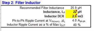

    I assume by quick start you mean the Excel design tool you had linked, and it matches

  • (I am Dave's colleague) The geometry of gate traces is as follows:
    HO- 14 mils wide,  820mils to series resistor, then 230 mils to first FET, 480 mils to second FET
    LO-  14 mils wide, 350 mils to series resistor, then 160 mils to first FET, 380mils to second FET
    Stackup is 6 layers, with 10 mils from above traces to ground planes
  • Orlando, Excel sheet attached. The compensation values calculated by the sheet are substantially different than those provided by Webench, we are changing them now...
    Interface board PS.xlsm
  • success! setting the compensation network components to the values generated by the Excel sheet design tool VS the values generated by Webench resolved the issue, no audible noise and the bench supply drops to zero amps out with no load on the switcher.

    The compensation depends heavily on the output capacitance, the webench had much smaller output capacitance and tats why the compensation was different from Quickstart.
