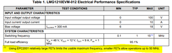

    The LMG1210 EVM uses the BAT46WJ Schottky diode, and this could be a helpful starting point for your search. The EVM is actually rated for 15MHz, but mentions that the EPC2001 GaN FET is a large FET (high Qg) and limits the switching frequency of the EVM:
    In addition to the optimizing efficiency through dead time control document, the team also has a document available on optimizing multi-MHz gate driver design. Pages 3 and 4 of this document discuss reverse recovery and some of the trade-offs and considerations of the Schottky diode as well as a PN junction diode.

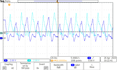

    Here is an image of the LMG1210EVM switching at 50% duty cycle, 50MHz, and no bus voltage:
    I cannot guarantee the Schottky diode's performance, but the waveform helps capture the capabilities of the EVM's BAT46WJ diode. As I previously mentioned, choosing a Schottky diode with a low forward voltage drop and low junction capacitance as well as following the guidelines from the "optimizing multi-Mhz gate driver design" article will help maximize the switching frequency capability.
