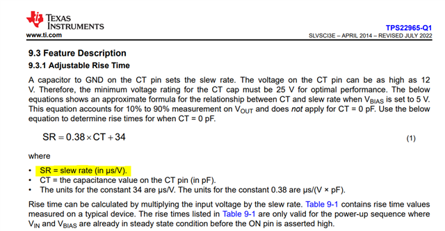

1. Inside the TI datasheet for TPS22965-Q1 the unit of slew rate is mentioned as shown below(us/V). But slew rate is change in voltage w.r.to time and unit is Volt/us right. Can you please check and confirm ?

  • Siburaj,
    Yes, the slew rate calculation is in microseconds per volt, so the conversion would have to be done from microseconds to seconds if you want to convert.
    "worst-case calculation" is pretty open- but it seems that you have all the right parameters there.

  • Hi Timothy,
    Thanks for your quick response.
    Normally slew rate unit will be in volt per microsecond or volt per second right.
    I have checked multiple documents and everywhere the unit mentioned is volt per microsecond instead of microseconds per volt mentioned in TI Datasheet.
