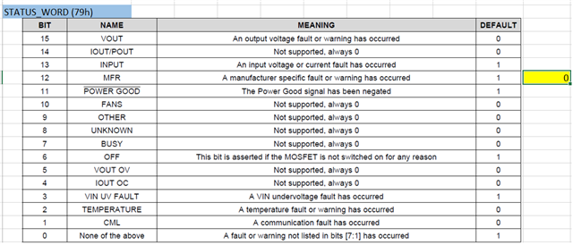

According to our customer, in one of their boards containing LM25066 he noticed a UV fault occurred.

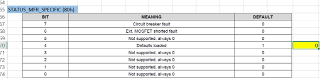

When he changed the threshold for UV fault and give clear fault with 0X03 he sees a manufacturer fault as shown in the screenshot below.
Our customer would like to know the details about manufacturer specific fault and why this occurs.
