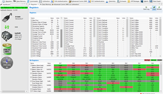

I am working on a 2-cell design with the BQ40Z80. I have set the cell count to 2 and also written the mAh, cWh, and pack voltage values to Data Memory. See below:
However, after resetting the device, it still reads as zero capacity and the Remaining Capacity Alarm is preventing the charging path from turning on. Cells are each at 3.9V, so nowhere near empty and the analog front end appears to be reading them correctly. Remaining cell inputs are shorted together on the EVM terminal block. See below:

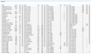

  • Hi Wyatt,
    I have been making some progress. The EVM kit is working now, so we switched to our prototype board with the same settings (i.e. export from the EVM, import and write to the prototype). However this is not working. Specifically, the FET gate voltages are off. I did a compare on the registers from the EVM and prototype and the summary of the differences, with my questions, is shown below:
    For a complete view, in case I missed anything, here is the registers and live readings for the working Eval kit:
    Here is the same screen shots for the prototype board:

  • Hello Jamie,
    If the FUSE bit is set you will not be able to turn on the FETs, which is why they are disabled. You will need to clear the FUSE bit first. Generally this is set when the secondary protector blows the fuse and the gauge senses the voltage on the FUSE pin. Can you share the schematic? If you do not use the FUSE pin make sure it is grounded and disabled in firmware so it doesn't float and trigger the fuse randomly.
