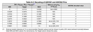

I have a question about "Table 9-5" in the datasheet.
It seems that the mode setting changes depending on the combination of decoded values of ADCIN1 and ADCIN2.
I do not understand the relationship between the meaning of numerical values such as Decode value "7,5,2,1" and the AD input value.

Although it is not mentioned in the datasheet, I referred to the diagram in the above thread.
Is it correct to understand that the calculated value of "0 to 7" can be obtained by inputting the value of "target" x 3.3V to ADCIN1/ADCIN2?
(The TPS25750 LDO_3.3V pin output can be divided down and connected to ADCINx.)

    Yes you are correct there is a table missing from the data sheet for the decoded values. I will elaborate on how the ADCINx pins are used to setup TPS25750.
    The ADCINx pins use a decoded value based off 3 different charts in order for you to understand how the device will behave in different environments. The first table you will use is actually the one that is missing, see below:
    This chart will tell you your decoded value on the ADCIN1 and ADCIN2. These decoded values are dependent on resister divider tied to your pins when being tied to LDO3V3. For instance, if you have a .50 resistor divider connected to LDO 3V3, your decoded value would give you 5. Once you have your decoded values for both ADCINx pins, you can use the pin strapping chart to determine default behavior and the I2C address setting chart to determine your slave address for the device.
