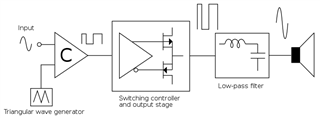

Can the TAS5612LADDVR or another chip  be used as a power supply?
I need a unipolar sinusoidal AC constant-voltage power source
  • 100 kHz sine out
  • 0V to 5V RMS
  • 0A to 25A continuous
  • 125W continuous
  • Inductive load
  • input: 12V to 24V DC
So, the "audio" input would be a 100 kHz sine wave.
I assume to regulate output voltage, i would change the amplitude of the input sine.
