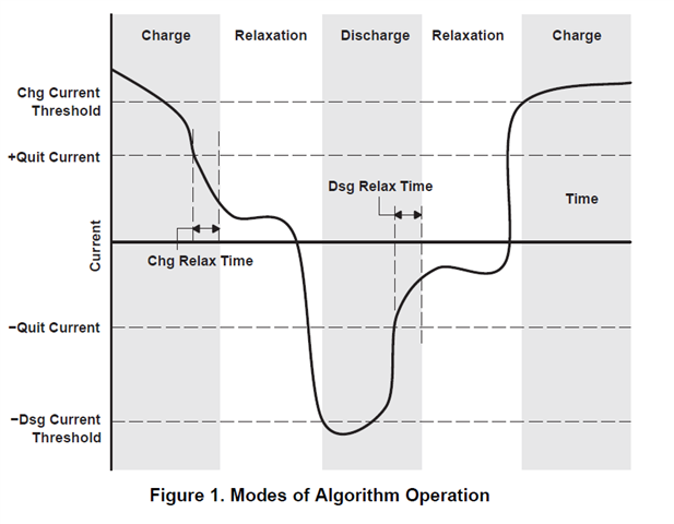

  3. Is SLUA903 the correct document to be using for the learning cycle?  Paragraph 2.5 of this document states "
    quit current must be less than the Dsg Current Threshold and Chg Current Threshold."  This makes no sense when referencing the charge cycle diagram in the same document (see below).

    #3: The absolute value of quit current must be less than the absolute value of chg and dsg current threshold. These thresholds control the gauge state machine which must follow the state of the cell (charge, discharge, relax).
