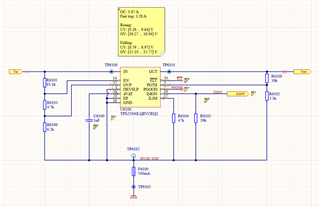

We have a question regarding TPS25940-Q1 eFUSE latching version.
We have a normal slow-blow fuse between the eFUSE GND and global GND to disable the eFUSE in case of any internal short.
However, we are experiencing an issue - when the fuse fails and the eFUSE GND and global GND become disconnected, the output of the eFUSE remains active.
The fault pin is pulled low to the local eFUSE GND, and because it is an open-drain output, its MOSFET is enabled, allowing internal logic to continue working and keeping the output enabled.
Do you have advise what may be causing this issue, or any suggestions for testing?

    Even though eFuse ground is disconnected, there are internal parasitics which forms path from IN to OUT when device ground gets disconnected
    Are you trying to avoid series fuse in the main power path ?

    Sorry for the late reply, I hadn't noticed that Bart posted here about my problem.
    I'm sharing our schematic of the eFUSE configuration. As you can see if the F6100 blows the GND path is disconnected but the eFUSE is still operational and is letting the current pass through. The voltage between TP6102 and TP6103 is around +5V.
  • thanks for the details Marin.
    Can you test by adding parallel shunt resistor 1k~2k Ohm. When the fuse blows, this resistor provides reference path for the eFuse ground
