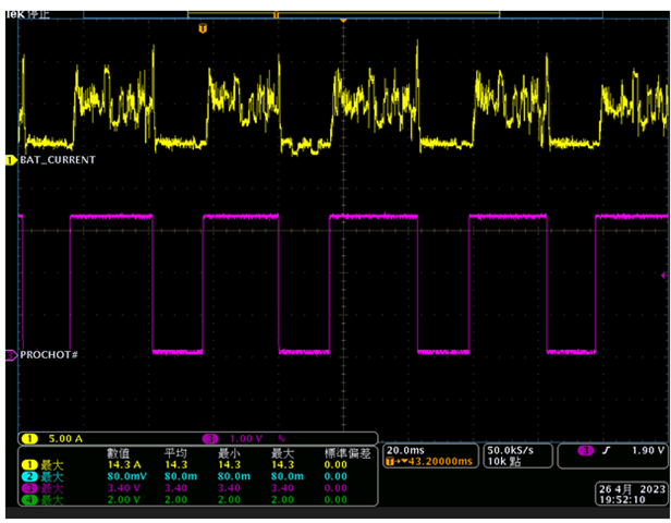

Hi team,
customer see prochot trigger within 78ms or smaller,
but I thought IDCHG prochot should follow deglitch setting time which is 78ms.
is there any other cause or setting that might cause IC ignore deglitch time?

Hi Fred,
What is your IDCHG1 level? The PROCHOT could be triggered by other events as well.
